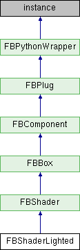

Inheritance diagram for FBShaderLighted:Public Member Functions | |
