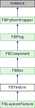

Inheritance diagram for FBTexture:Public Member Functions | |
