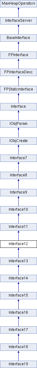

#include <maxapi.h>
Extends Interface11 Client code should retrieve this interface using GetCOREInterface12.
