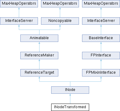

Inheritance diagram for INodeTransformed:
