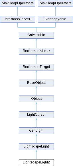

| virtual void | SelectAll (int selLevel) |
| This method is called to select every element of the given sub-object level. | |
| virtual void | InvertSelection (int selLevel) |
| This method is called to invert the specified sub-object level. | |
| virtual int | SubObjectIndex (HitRecord *hitRec) |
| Returns the index of the sub-object element identified by the HitRecord hitRec. | |
| virtual void | ActivateSubobjSel (int level, XFormModes &modes) |
| When the user changes the selection of the sub-object drop down, this method is called to notify the plug-in. | |
| virtual BOOL | SupportsNamedSubSels () |
| An object that supports sub-object selection can choose to support named sub object selection sets. | |
| virtual void | ActivateSubSelSet (MSTR &setName) |
| When the user chooses a name from the drop down list this method is called. | |
| virtual void | NewSetFromCurSel (MSTR &setName) |
| If the user types a new name into the named selection set drop down then this method is called. | |
| virtual void | RemoveSubSelSet (MSTR &setName) |
| If the user selects a set from the drop down and then chooses Remove Named Selections from the Edit menu this method is called. | |
| virtual void | SetupNamedSelDropDown () |
| To support the Edit Named Selections dialog, plug-ins must implement this method. | |
| virtual int | NumNamedSelSets () |
| virtual MSTR | GetNamedSelSetName (int i) |
| virtual void | SetNamedSelSetName (int i, MSTR &newName) |
| virtual void | NewSetByOperator (MSTR &newName, Tab< int > &sets, int op) |
| virtual void | GetSubObjectCenters (SubObjAxisCallback *cb, TimeValue t, INode *node, ModContext *mc) |
| When the user is in a sub-object selection level, the system needs to get the reference coordinate system definition from the current modifier being edited so that it can display the axis. | |
| virtual void | GetSubObjectTMs (SubObjAxisCallback *cb, TimeValue t, INode *node, ModContext *mc) |
| virtual void | NotifyPreCollapse (INode *node, IDerivedObject *derObj, int index) |
| This method is called before a modifier or object is collapsed. | |
| virtual void | NotifyPostCollapse (INode *node, Object *obj, IDerivedObject *derObj, int index) |
| This method is called after a modifier or object is collapsed. | |
| virtual int | NumSubObjTypes () |
| Objects and modifiers that support subobjects have to overwrite this method - as well as GetSubObjType() - and return a class derived from ISubObjType in GetSubObjType(). | |
| virtual ISubObjType * | GetSubObjType (int i) |
| Returns a pointer to the sub-object type for the sub-object whose index is passed. | |
| virtual CoreExport int | GetSubObjectLevel () |
| This method returns an integer which indicates the current sub-object level of the modifier or base object. | |
| virtual void | SetGenUVW (BOOL sw) |
| This method is called to change the state of its Generate UVW boolean. | |
| virtual void | SetGenUVW (int mapChannel, BOOL sw) |
| This method is called to change the state of its Generate UVW boolean for the specified mapping channel. | |
| virtual void | ShowEndResultChanged (BOOL showEndResult) |
| This method notifies the BaseObject that the end result display has been switched (the "Show End Result" button has been toggled). | |
| Public Member Functions inherited from ReferenceTarget | |
| CoreExport void | GetClassName (MSTR &s, bool localized=true) const override |
| Retrieves the name of the plugin class. | |
| CoreExport SClass_ID | SuperClassID () override |
| Retrieves a constant representing the type of the plugin. | |
| BOOL | IsRefTarget () override |
| Checks if this is a ReferenceTarget. | |
| CoreExport RefResult | TestForLoop (const Interval &refInterval, RefMakerHandle hmaker) |
| Tests for a cyclical reference. | |
| CoreExport BOOL | HasDependents () |
| Checks if a ReferenceTarget has references. | |
| CoreExport BOOL | HasRealDependents () |
| Checks if this has Real (Strong) Dependents. | |
| void | BeginDependencyTest () |
| Starts Dependency Test. | |
| BOOL | EndDependencyTest () |
| Ends Dependency Test. | |
| virtual void | RefAdded (RefMakerHandle rm) |
| Called after a reference is made to a target. | |
| virtual void | RefAddedUndoRedo (RefMakerHandle rm) |
| Called after a reference is made to a target because of undo or redo. | |
| virtual void | RefDeleted (ReferenceMaker *oldOwner) |
| Called after a reference to this is deleted. | |
| virtual void | RefDeletedUndoRedo (RefMakerHandle oldOwner) |
| Called after a reference to this is deleted because of undo or redo. | |
| CoreExport RefResult | DeleteAllRefsToMe () override |
| Deletes all references to this ReferenceTarget. | |
| CoreExport RefResult | TransferReferences (RefTargetHandle oldTarget, BOOL delOld=FALSE) |
| Transfers all the references from oldTarget to this. | |
| CoreExport int | DoEnumDependents (DependentEnumProc *dep) |
| Begins an enumeration that searches back in the dependency network. | |
| virtual CoreExport RefTargetHandle | Clone (RemapDir &remap) |
| This method is used by 3ds Max to clone an object. | |
| virtual CoreExport void | BaseClone (ReferenceTarget *from, ReferenceTarget *to, RemapDir &remap) |
| This method copies base class data from an object to its clone. | |
| CoreExport RefResult | NotifyDependents (const Interval &changeInt, PartID partID, RefMessage message, SClass_ID sclass=NOTIFY_ALL, BOOL propagate=TRUE, RefTargetHandle hTarg=nullptr, NotifyDependentsOption notifyDependentsOption=REFNOTIFY_ALLOW_OPTIMIZATIONS) override |
| Notify all dependent RefMakers concerned with the message. | |
| void | FlagDependents (TimeValue t, PartID which=PART_PUT_IN_FG) |
| This sends the REFMSG_FLAGDEPENDENTS message up the pipeline. | |
| virtual void | NotifyForeground (TimeValue t) |
| This method is called to flag dependents into the FG. | |
| virtual void | NotifyTarget (int message, ReferenceMaker *hMaker) |
| Sends messages to ReferenceTargets. | |
| CoreExport void * | GetInterface (ULONG id) override |
| Inherited from Animatable. | |
| CoreExport BaseInterface * | GetInterface (Interface_ID id) override |
| CoreExport | ReferenceTarget () |
| Constructor. | |
| virtual CoreExport RefResult | AutoDelete () |
| Deletes the object when it has no more real dependents. | |
| CoreExport RefResult | MaybeAutoDelete () |
| Public Member Functions inherited from ReferenceMaker | |
| CoreExport RefResult | ReplaceReference (int which, RefTargetHandle newtarg, BOOL delOld=TRUE) |
| Used when cloning reference makers. | |
| CoreExport RefResult | DeleteAllRefsFromMe () |
| Deletes all references from this ReferenceMaker. | |
| CoreExport RefResult | DeleteAllRefs () |
| Deletes all references both to and from this item. | |
| CoreExport RefResult | DeleteReference (int i) |
| Deletes the specified reference. | |
| virtual BOOL | CanTransferReference (int i) |
| Tells whether this reference can be transfered. | |
| CoreExport ReferenceSaveManager & | GetReferenceSaveManager () |
| Access the ReferenceSaveManager of this ReferenceMaker. | |
| virtual CoreExport IOResult | Save (ISave *isave) |
| Called for saving data. | |
| virtual CoreExport IOResult | Save (ISave *isave, ChannelMask) |
| virtual CoreExport IOResult | Load (ILoad *iload) |
| Called for loading data. | |
| virtual CoreExport IOResult | Load (ILoad *iload, ChannelMask) |
| virtual int | RemapRefOnLoad (int iref) |
| Used to load old files with references. | |
| virtual CoreExport void | RescaleWorldUnits (float f) |
| Rescale size of all world units in object and its reference hierarchy. | |
| CoreExport void | EnumAuxFiles (AssetEnumCallback &assetEnum, DWORD flags) override |
| Enumerate auxiliary files (e.g. bitmaps) | |
| virtual CoreExport void | SaveEnum (SaveEnumProc &sep, BOOL isNodeCall=0) |
| The default save enumeration. | |
| virtual CoreExport bool | SpecifySaveReferences (ReferenceSaveManager &referenceSaveManager) |
| Used to specify reference slot remapping during scene file save. | |
| CoreExport bool | EnumRefHierarchy (RefEnumProc &proc, bool includeCustAttribs=true, bool includeIndirectRefs=true, bool includeNonPersistentRefs=true, bool preventDuplicatesViaFlag=true) |
| This method provides a general purpose reference enumerator. | |
| CoreExport int | FindRef (RefTargetHandle rtarg) |
| Get the index of the ReferenceTarget. | |
| BOOL | IsRefMaker () override |
| Tells whether it is a ReferenceMaker. | |
| virtual BOOL | IsRealDependency (ReferenceTarget *rtarg) |
| Returns whether this is a "real" (strong) dependency or not. | |
| virtual BOOL | ShouldPersistWeakRef (RefTargetHandle rtarg) |
| Specifies whether a weak reference is to be persisted on a partial load or save. | |
| CoreExport | ReferenceMaker () |
| Constructor. | |
| CoreExport void | DeleteMe () |
| Deletes an instance of this class. | |
| virtual CoreExport int | NumRefs () |
| Returns the total number of references this ReferenceMaker can hold. | |
| virtual CoreExport RefTargetHandle | GetReference (int i) |
| Returns the 'i-th' reference. | |
| Public Member Functions inherited from Animatable | |
| virtual void | FreeCaches () |
| virtual int | NumChildren () |
| virtual Animatable * | ChildAnim (int i) |
| virtual CoreExport MSTR | NodeName () |
| virtual void | EditTrack () |
| virtual CoreExport BOOL | SubAnimSetKeyBufferPresent (int subNum) |
| returns true if the sub-anim has a "Set Key" buffer present | |
| virtual BOOL | SetKeyBufferPresent () |
| returns true if there is a "Set Key" buffer present | |
| virtual CoreExport void | SubAnimCommitSetKeyBuffer (TimeValue t, int subNum) |
| Commit any "Set Key" buffers on the given sub-anim. | |
| virtual void | CommitSetKeyBuffer (TimeValue t) |
| Commit any "Set Key" buffers. | |
| virtual CoreExport void | SubAnimRevertSetKeyBuffer (int subNum) |
| Revert any "Set Key" buffers on the given sub-anim. | |
| virtual void | RevertSetKeyBuffer () |
| Revert any "Set Key" buffers. | |
| virtual LRESULT CALLBACK | TrackViewWinProc (HWND hwnd, UINT message, WPARAM wParam, LPARAM lParam) |
| This function is obsolete. | |
| virtual bool | IsParamBlockDesc2Used (ParamBlockDesc2 *desc) |
| Returns true if the passed description is being used. | |
| virtual bool | GetMacroRecorderName (bool used_as_rhs_value, MSTR &objectSpecifiedName) |
| This method is called to access the object specified name to use for the Maxscript macrorecorder. | |
| CoreExport | Animatable () |
| Constructor. | |
| virtual CoreExport void | DeleteThis () |
| MSTR | ClassName (bool localized=true) const |
| Returns the name of the plugin class. | |
| virtual CoreExport Class_ID | ClassID () |
| Retrieves a constant that uniquely identifies the plugin class. | |
| virtual void | BeginEditParams (IObjParam *ip, ULONG flags, Animatable *prev=NULL) |
| virtual void | EndEditParams (IObjParam *ip, ULONG flags, Animatable *next=NULL) |
| virtual CoreExport void | ReleaseInterface (ULONG id, void *i) |
| virtual CoreExport int | SetProperty (ULONG id, void *data) |
| virtual CoreExport void * | GetProperty (ULONG id) |
| CoreExport void | AppendProperty (AnimProperty *prop) |
| A function to directly add arbitrary properties to this object developers should ensure that the properties ID does not conflict with any Max-specific IDs. | |
| CoreExport AnimProperty * | FindProperty (DWORD id) |
| Find any property. | |
| CoreExport void | AddAppDataChunk (const Class_ID &cid, SClass_ID sid, DWORD sbid, DWORD len, void *data) |
| Adds application/plugin specific (custom) data to an Animatable. | |
| CoreExport AppDataChunk * | GetAppDataChunk (const Class_ID &cid, SClass_ID sid, DWORD sbid) |
| Retrieves the application/plugin specific (custom) data stored with an Animatable. | |
| CoreExport BOOL | RemoveAppDataChunk (const Class_ID &cid, SClass_ID sid, DWORD sbid) |
| Deletes the application/plugin specific (custom) data stored with an Animatable. | |
| CoreExport void | ClearAllAppData () |
| Deletes all application/plugin specific (custom) data stored with an Animatable. | |
| virtual int | NumSubs () |
| virtual Animatable * | SubAnim (int i) |
| virtual CoreExport MSTR | SubAnimName (int i, bool localized) |
| virtual BOOL | CanDeleteSubAnim (int i) |
| virtual void | DeleteSubAnim (int i) |
| virtual DWORD | GetSubAnimCurveColor (int subNum) |
| virtual int | SubNumToRefNum (int subNum) |
| virtual BOOL | CanCopyAnim () |
| CoreExport int | HasSubElements (int type=0) |
| virtual int | GetSubFCurveExtents (int subNum, ParamDimensionBase *dim, float &min, float &max, DWORD flags) |
| The values max and min should be initialized before calling this function. | |
| virtual ParamDimension * | GetParamDimension (int i) |
| virtual BOOL | SelectSubAnim (int subNum) |
| virtual BOOL | BypassTreeView () |
| virtual BOOL | BypassTrackBar () |
| virtual BOOL | BypassPropertyLevel () |
| virtual BOOL | InvisibleProperty () |
| virtual int | NumKeys () |
| virtual TimeValue | GetKeyTime (int index) |
| virtual int | GetKeyIndex (TimeValue t) |
| virtual BOOL | GetNextKeyTime (TimeValue t, DWORD flags, TimeValue &nt) |
| virtual void | CopyKeysFromTime (TimeValue src, TimeValue dst, DWORD flags) |

Extension to Photometric light This interface extends class LightscapeLight with new functionality in 3ds Max 2016.
pure virtual |
Bakes a web distribution into a spherical map.
Bakes the web (IES) distribution into a spherical map of floating-point intensities which are to be multiplied against the light's global intensity value. The resulting texture has the x coordinates covering the horizontal angles, from -PI to PI radians, and the y coordinates covering the vertical angles, from 0 to PI radians, 0 being +Z and PI being -Z. The rotation of the web distribution, returned by GetWebRotateX() and friends, is baked in the result. The resolution of the baked texture is determined internally and is based on the resolution of the original data from the web distribution (.ies) file.
| [out] | bakedDistribution | - An array of floating-point intensities which is allocated and filled by the method. The array represents a spherical texture map. The size of the array is: bakedWidth * bakedHeight. |
| [out] | bakedWidth | - The width of the baked spherical texture map. |
| [out] | bakedHeight | - The height of the baked spherical texture map. |
