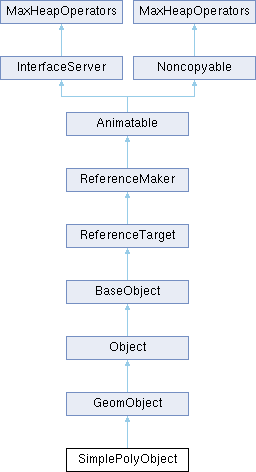

Inheritance diagram for SimplePolyObject:

Detailed Description
This is a base class for creating procedural objects compatible with Editable Poly.
This class implements many of the methods required to create a procedural object. The only limitation for a procedural object using SimplePolyObject as a base class is that it must represent itself with an MNMesh. These objects allow non-triangular faces and support edge and vertex creasing for OpenSubdiv and other subdivision systems.
Procedural Object plug-ins which subclass off SimplePolyObject must implement some methods. These are noted, as are default implementations of other methods.
Note: Methods of the base class refer to the protected data members. For example the base class implementations of the bounding box methods use the polyMesh data member. Therefore the plug-in derived from SimplePolyObject must use these same data members.
See also
GeomObject, IParamBlock2, MNMesh.
