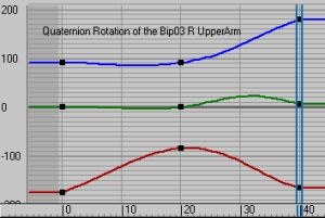

Quaternion/Euler rollout, notice that the Quaternion option is active by default. Note: If you change options for that biped limb, your choice is preserved in the 3dsmax.ini file, from which it is restored after a scene reset or session change. - On the Biped Apps rollout, click Workbench to open the Animation Workbench dialog.
The animation is displayed as three separate TCB rotation curves labeled “Quaternion Rotation”.

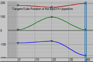

- On the Quaternion/Euler rollout, choose the Euler option.
The curves have been converted to display Euler controlled rotations. You now have access to the curve's tangent handles to change the curve's interpolation.
The animation is displayed as three separate Euler curves labeled “Tangent Euler Rotation”.
- Choose a different axis ordering from the Axis Order drop-down list (under the Euler option).
The curve display changes to reflect the new ordering while preserving the biped posture.
