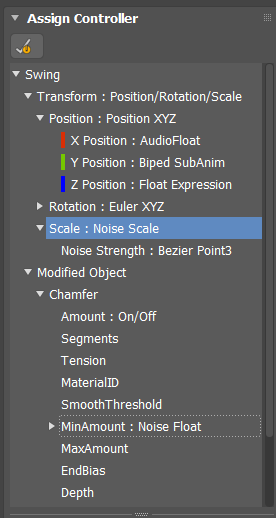

The Assign Controller rollout assigns and appends different transform controllers to individual objects. You can also assign controllers in Track View. Animation controllers are plug-ins that handle all of the animation tasks in 3ds Max. For a complete list of available Animation controllers, see Animation Controllers.
Interface
Assign Controller -
Displays a selectable list of controllers for a selected track.
Once controllers have been added, right-click the Biped SubAnim entry in the list and choose Properties to display the SubAnims dialog.
