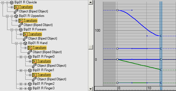

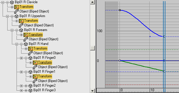

Separate Tracks
By default, Biped uses an optimized method for storing animation keys. For example, keys for the fingers, hand, forearm, and upper arm are stored in the Clavicle transform track. If you prefer instead to have a transform track available for each arm object, use the Separate FK Tracks settings to make these transform tracks available; separate tracks are displayed in Track View.
When the Separate FK Tracks options are on for the Arms and Fingers, only these tracks receive keys.
When the Separate FK Tracks options are off, all limb tracks receive keys.
Tip: Separate FK tracks are designed to be used with forward-kinematics (FK) rotations. Using the Move tool to change the position of a biped limb with Separate FK Tracks on requires that Set Parents Mode be enabled. If Set Parents Mode is off, then the limb you move is stored relative to its parent objects, and the new parent positions are not stored. The parent objects will snap back to their originally stored location. Turning on Set Parents Mode ensures that the position of the entire biped limb is stored.
Note: Use Separate FK Tracks settings as a preference. It is better to turn them on once for the tracks you plan to edit by hand. Turning off Separate Tracks that are currently on causes a key to be stored for every biped object in the limb for the frames where any biped keys previously existed.

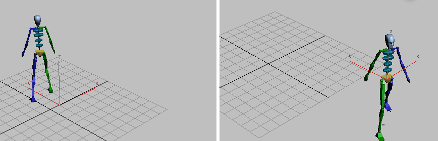

Mirror and Mirror In Place flyout
This flyout offers two options. Both options mirror the animation locally, so that the right side of the biped now does what the left side does, and vice versa. Also, if the spline leaned to the left, it now leans to the right. The same goes for the neck, pelvis, head, and so on.
  • Mirror Reflects the animation about the world-space XZ plane. This option reverses the biped’s position by 180 degrees, so it now faces in the opposite direction.
  • Mirror in Place Reflects the animation locally, but at the initial frame, maintains the world-space position and orientation of the biped. The biped continues to face in the same direction.
    Original animation: The biped turns to the left as it walks.
    Left: When you click Mirror, the animation and the biped turn completely around.
    Right: When you click Mirror In Place, the biped still moves forward, but now it turns to the right.

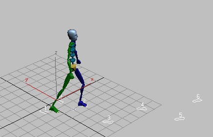

Bend Horizontal
Rotates selected keys horizontally about their up-axis. To use this, select the biped's COM, turn on (Trajectories) to see the path, use the Time Slider to select keys, and then adjust the Bend Horizontal value. The path curves.
Bend Horizontal is a relative value: After you adjust it, it returns to 0.0.
Tip: If the biped uses footsteps or IK on the leg keys, the feet will step into the footsteps or use the original keys regardless of the changed trajectory. If the biped uses motion-capture data, Bend Horizontal works but it might cause the feet to slide. This control is most effective during freeform animation when the biped is airborne (or swimming); see Freeform Animation Between Footsteps.
