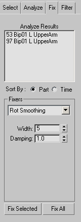

The Fix panel provides access to the tools that can be used to automatically fix the errors found by the Analyze panel.
A variety of methods is available to automatically correct errors found in the curves. Smoothing, blurring, and removing keys are all options. Or, if you prefer, you can correct the error manually by adjusting the interpolation per key, using standard 3ds Max methods. You can move the key on the curve, or right-click the key to access interpolation controls.
A fix is performed as a specific operation on a particular biped body part or set of parts, at a particular time. In general, fixes either change the value of a key or remove keys to produce corrected motion.
The results of last analysis are displayed in the Analyze Results list. Clicking an error in the list once displays the error as a yellow line over the curve; clicking the error twice updates the viewport scene, making the error the current frame. Errors can be sorted by Part or by Time.
Fixes can be applied to individual errors, selected errors, or to all errors at once.

Interface
- Analyze Results error list
- Displays all the errors the analyzer found for the selected body parts. The name of the Biped object is preceded by the frame number of the error. Clicking the error once displays a yellow line at that frame in the Curve View. Clicking it twice moves the current frame to match the error frame number: the viewports display that frame as well.
- Sort by:
- Lets you change the display of the error analysis results.
- Part: Displays all the errors for each part listed together.
- Time Displays all the errors sequentially, by frame.
Fixers group
- [fixer options drop-down list]
- Determines the method used to attempt to correct the errors found by the analyzer. In general, try to match the fixer to the analyzer property. For example, if you have selected a Noise detector with Rot Speed, then choose a Fixer with Rot in the name as well. The exception to this would be when it is obvious that you'd prefer to remove the keys rather than modify them. In that case, choose a Remove Keys fixer.

- Fix Selected
- Applies the Fixer operation to the selection in the Analyze Results error list.
- Fix All
- Applies the Fixer operation to all the errors, whether they are selected in the Analyze Results error list, or not.
