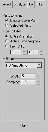

To filter a track:
- Choose the parts you want to filter: either just a particular curve, or an entire selection.
- Choose the time range you want to filter: either the entire biped animation, the active time segment, or a custom range.
- Choose the filter you want to apply. Adjust its individual parameter as required.
- Click Filter at the bottom of the panel.
- Observe the effect on the graph in the Curve view.
Play the animation and observe the difference, if any. Click
Undo if the results are unexpected or incorrect.

- Parts to Filter
- Sets the filter to act on either the display object or the entire selection of objects.
- Display Curve Part Sets the filter to act on the displayed object curves.
- Selected Parts Sets the filter to act on the active selection. Especially useful when working on the whole biped.
- Time to Filter
- Sets the range to be filtered to either the entire biped animation, the active time segment, or a custom range of frames.
- Entire Animation Sets the time to filter to be the complete biped animation (disregarding the active time segment).
- Active Time Segment Sets the time to filter to be the scene active time segment. You set the active time segment in the 3ds Max Time Configuration dialog.
- From / To: Sets the time to filter to a custom range of frames.
Filters group
- [filters list]
- Choose the filter to use from this drop-down list.
The available filter types include smoothing, blurring, boosting, key reduction, and subanims.

- Blurring, Smoothing, and Boosting parameters
Width Width is the size of the filter kernel width in frames. It tells you how much of the animation is taken into effect when filtering a specified keyframe.
Damping The Damping value changes how effective the filter should be. A higher value, the more dramatic the change. A damping value of 1.0 is normal filter behavior.

- Filter
- Click to apply the active filter to the selected tracks.
