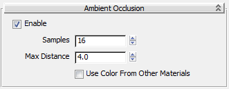

Interface
Note: Not all Autodesk Materials support ambient occlusion.
There are four controls for ambient occlusion:
Enable
When on, enables ambient occlusion (AO) and makes the remaining group controls available. Default=off.
Samples
The number of samples (rays) shot for creating AO. Higher values yield smoother results but render more slowly, while lower values render faster but look grainier. Values in the range 16 to 64 cover most situations. Range: 2 to 256. Default=16.
Max Distance
Defines the radius within which the renderer looks for occluding objects. Smaller values restrict the AO effect to small crevices only but are much faster to render. Larger values cover larger areas but render more slowly. Default=4.0.
The following illustrations show the raw AO contribution with two different distances:
Left: Higher Max Distance value
Right: Lower Max Distance value
Tip: To specify an infinite radius, set Distance to 0.0.
Use Color from Other Materials
When on, derives the AO coloring from surrounding materials, for more accurate overall results (also known as color bleeding). For example, a glowing material would return a brighter color than a dark material. Default=off.
Use Color From Other Mats is off.
Use Color From Other Mats is on.
If you find that using AO creates a "dirty" look with excessive darkening in corners, or dark rims around self-illuminated objects, turn on Use Color From Other Mats for a more accurate result.
