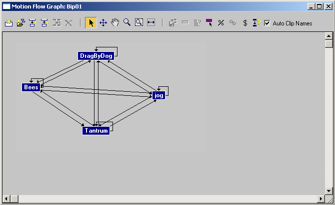

  2. On the Motion Flow rollout, click (Show Graph).
    This displays the Motion Flow Graph.

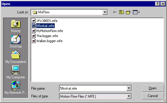

  3. On the Motion Flow rollout, click (Load File)
    3ds Max opens a file dialog.
  4. Choose an MFE file from the folder where your Motion Flow Editor files are stored.
    The clips and transitions appear in the Motion Flow Graph. Each transition displays its “weighting” value, 100 by default.
  5. On the Motion Flow Graph toolbar, click (Select Clip/Transition), and right-click a transition that you want to adjust.
    3ds Max opens the Transition Editor dialog.
  6. Adjust the Probability setting to give the transition a higher or lower probability of being randomly chosen for the motion flow script.
    Note: The Probability range is 0 to 100.
  7. On the Motion Flow Graph toolbar, click (Select Random Start Clips).
  8. Select the clip you want used as the start clip.
    The clip turns purple and is assigned a weighting of 100. The selected clip will be used first by any biped using the random motion script.

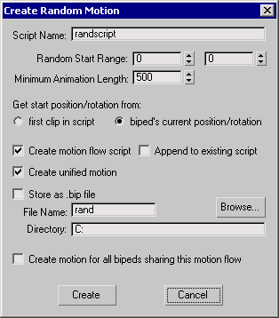

  9. In the Scripts section on the Motion Flow rollout, click (Create Random Motion).
  10. On the Create Random Motion dialog, set a value for Minimum Animation Length.
    This should be long enough to include the clips you want in the animation.
  11. Click Create.
    A random script is created based on clips in the Motion Flow Graph and the Minimum Animation Length.

  4. After adding several clips and transitions, click (Select Clip/Transition) and select all the clips.
  5. On the Motion Flow Graph, click (Create All Transitions). Click Yes when asked if you want to create a transition from each selected clip to itself.
  6. On the Motion Flow Graph toolbar, click (Select Random Start Clips).
    All the transitions linking clips are weighted at 100, meaning all the transitions have a even chance of starting first.
  7. Region-select all the clips in the Motion Flow Graph.
    The clips all turn purple and each is assigned a weighting of 100. All the clips have an even chance of starting first.
  8. In the Motion Flow rollout Scripts group, click (Create Random Motion).
  9. On the Create Random Motion dialog, set a value for Minimum Animation Length.
  10. Click Create.
    3ds Max creates a random script based on clips in the Motion Flow Graph. You can vary clip and transition percentages in the clip dialog or Transition Editor to favor a clip or transition if you like.
