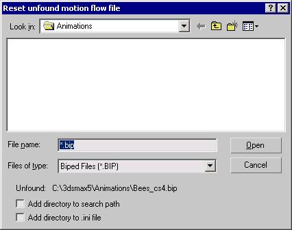

  • From the Reset Unfound Motion Flow Files dialog, direct 3ds Max to the folder where the missing BIP file resides.

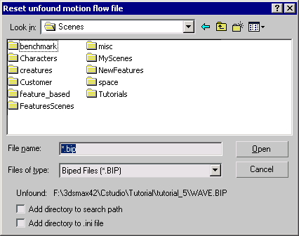

    If referenced BIP files cannot be found, the Reset Unfound Motion Flow File dialog is displayed.
  2. If any of the referenced BIP files are on your local drive, navigate to the folder where they reside and select the BIP file.
  3. Turn on the “Add Directory To .ini File” option, and click Open.
    Turning on the Add Directory To .ini File option automatically adds another MoFlowDir= line to your biped.ini file.
    Note: Turn on Add Directory to Search if you want to search for referenced BIP files during your current session, but do not want to add the directories to the biped.ini file.
