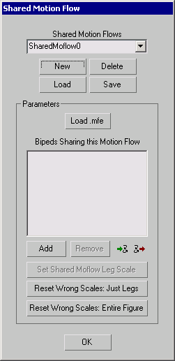

(Motion Flow Mode). - On the Motion Flow rollout, click
(Shared Motion Flow). 3ds Max opens the Shared Motion Flow dialog.
- On the Shared Motion Flow dialog, click New.
3ds Max creates a new shared motion flow.
- In the Shared Motion Flow dialog
Parameters group, click Add. - On the Select dialog, choose all the bipeds.
The bipeds are added to the list. If you add clips to the motion flow graph they will be shared by the bipeds.
- Click OK to close the Shared Motion Flow dialog.

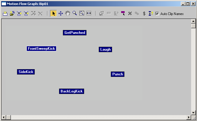

- Click
(Create Multiple Clips) and add three or four clips (or more) to the Motion Flow Graph. 3ds Max opens a file dialog, where you can choose the location of your BIP files.
- After adding the clips, click
(Move Clips) and arrange the clips so they are not so close to one another. This will make it easier to see the transitions later.

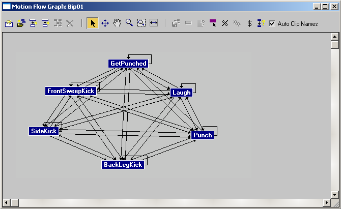

- Click
(Select Clip/Transition) and region-select all the clips. - On the Motion Flow Graph, click
(Create All Transitions), and click Yes when asked if you want to create a transition from each selected clip to itself.

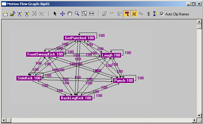

- On the Motion Flow Graph toolbar, turn on
(Select Random Start Clips). All the transitions linking clips are weighted at 100, meaning all the transitions have a even chance of being chosen randomly.
- Region-select all the clips in the Motion Flow Graph dialog.
The clips all turn purple and each is assigned a weighting of 100. Now all the clips have an even chance of starting first.
