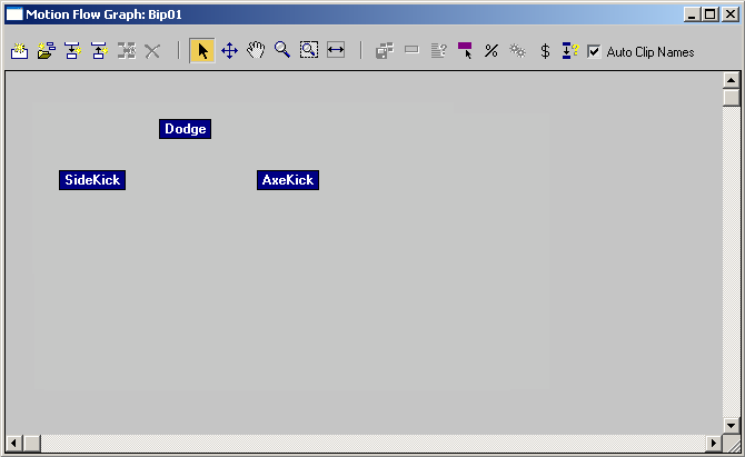

- Create a Motion Flow Graph with three or more motion files.
For information on how to set up the graph, see To create multiple clips in the Motion Flow Graph.

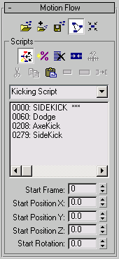

- Create a script using the clips in the Motion Flow Graph.
For information on how to create a script, see To create Motion Flow Scripts.
A sample script called Kicking Script containing four clips

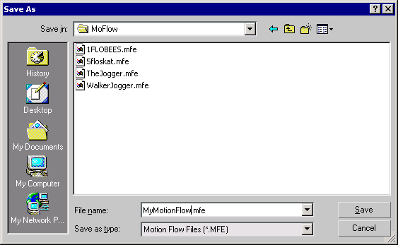

- Click
(Save File) to save a Motion Flow Editor MFE file. 3ds Max opens the Save As dialog.
- Specify a folder on your hard drive where you plan to store your Motion Flow Editor files.

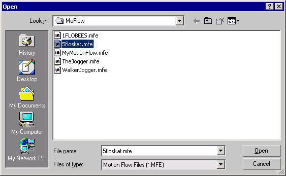

(Load File). 3ds Max opens a file dialog.
- Navigate to the folder where your MFE files are stored.
- Choose the file to load.
- Select an MFE file from the folder where your Motion Flow Editor files are stored.
- Click
(Append File). 3ds Max opens a file dialog again.
- Choose a different MFE file.
