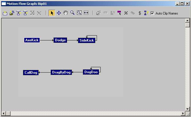

  4. On the Motion Flow Graph toolbar, turn on either (Create Transition From -> To) or (Create Transition To <- From) and then drag from one clip to another clip.
    The top set of clips are linked using Create Transition From->To. The bottom set of clips are linked using Create Transition To<-From.
