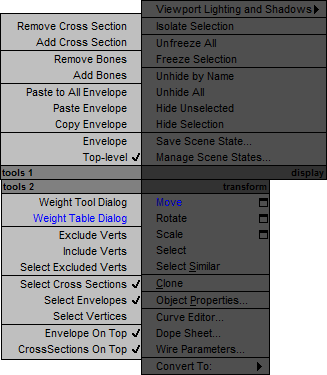

Quad Menu
A number of Skin modifier commands are available from the quad menu on the Tools 1 and Tools 2 quadrants. These also appear on the Skin modifier rollouts and are described in the respective topics.
