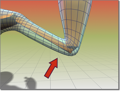

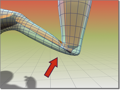

Bending the arm without the Morph Angle deformer causes the sleeve to crumple.
Using the Morph Angle deformer creates a smooth bend in the sleeve.
