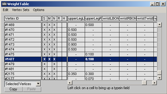

The weight table for the Skin modifier is used to change vertex weights for several vertices and bones at a time. This table appears when you click the Weight Table button.
Interface
Vertex numbers appear down the left column, while bone names appear across the top. Vertex weights for each bone are displayed in the chart. You can change vertex weights in a number of ways:
- Click and drag a vertex weight to the left or right.
- Highlight a weight and type in a new weight.
- Select vertices by dragging over vertex IDs, then click and drag one weight to change all selected weights for the bone.
- Right-click to enter a value of 0.
- Ctrl+right-click to enter a value of 1.0.

Dialog options
- Vertex ID
Vertices are displayed by number down the left column of the weight table. Double-click a vertex number to cause the vertex to display in pink in viewports. To display only selected vertices, choose Selected Vertices from the drop-down menu at the bottom left of the dialog.
- S
Indicates vertex is selected.
- M
Indicates vertex weight has been modified.
- N
Indicates vertex weights are normalized (total of all vertex weights is always 1.0).
- R
Indicates vertex is rigid (affected only by one bone, the one with the most influence).
- H
Indicates patch handles are rigid (affected only by one bone, the one with the most influence).
- Vertex selection drop-down list
Choose to display all vertices, selected vertices or only vertices affected by the selected bone.
- Copy
Copies weights for highlighted vertices.
- Paste
Pastes copied weights.
