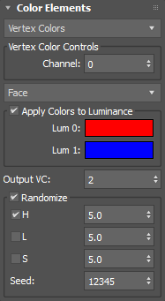

Color Elements Parameters rollout
Example with Vertex Colors input selected. Parameters vary with other inputs.
Input menu
Selects where data is collected from: Vertex Colors, Map, Soft Selection, or From Stack.
Vertex Color Controls group
Channel
Sets the vertex color channel. Displays only when Vertex Colors is selected as the input.
Map Controls group
Map Channel
Sets the map channel. Displays only when Map is selected as the input.
Map button
Click to choose a map from the Material/Map browser. Displays only when Map is selected as the input.
You can also drag and drop a map from a Material Editor sample slot. If the Slate Material Editor is open, you can drag from a map node's output socket, then drop onto this button. You can also drag and drop from a map button in the Material Editor or anywhere else in the 3ds Max interface. When you drop a map , a dialog asks if you want the map to be a copy (independent) or an instance of the source map.
Use Element Center
Samples the color at the center of the given element, turning averaging off.
Color By menu
Selects coloring by Face or Element.
Apply Colors to Luminance toggle
When enabled, applies colors as a gradient to the luminance value. Click the color swatches to assign the colors.
Output group
Output VC
Selects a map channel for outputting the vertex color.
Randomize
Randomizes based on hue, luminance or saturation. Use the Seed field to change the pattern.
