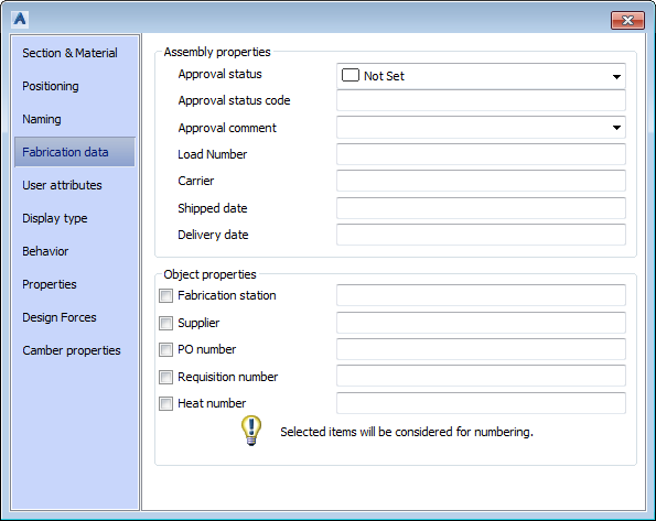

Beam Dialog: Fabrication Data Tab
Model objects and assemblies have different fabrication information available in the model, depending on the project state.
Assembly properties
  • Approval status
  • Approval status code
  • Approval comment
  • Load number - delivery note number
  • Carrier
  • Shipped date
  • Delivery date
The assembly fabrication data is available only after you define the assembly (by numbering or using Define as main part from the element properties dialog in the Naming tab). The assembly fabrication data is defined on assembly and is identical for all the assembly components.
The approval status, approval status code and approval comment mark the modeling status of an assembly.
Object properties
  • Fabrication station
  • Supplier
  • PO number - Purchase Order Number
  • Requisition number - identifier code that is used to reference a particular requisition
  • Heat number - an identification coupon number that is stamped on a material plate after it is removed from the ladle and rolled at a steel mill.
The object fabrication data is always available and is defined on each object, even if some objects have the same part mark.
Note: You can run numbering, based on the values of object fabrication data parameters:
  • Supplier
  • PO number
  • Heat number
