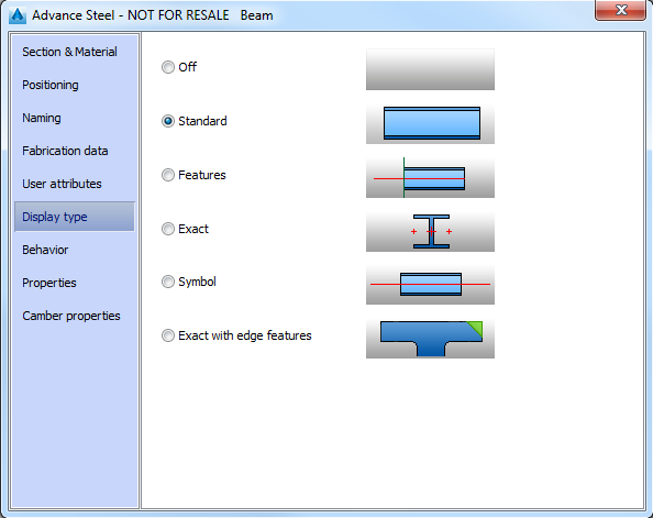

On this tab of the beam properties dialog box, you can select the beam representation type in the model.
An Advance beam can be displayed in five representation styles:
Display type | Beam | Description |
Standard |
Section edges and insertion axes of the beam. |
Features |
Section edges and processing objects. |
Exact |
Section edges and gauge lines, crosses on end points of the insertion axis and four reference points in the start and end plane. |
Symbol |
Insertion axis and a small part of the beam in the center. |
Exact with edge features |
Section edges and edge processing objects. |
In each representation type, the beam has different grip points:
Standard |
End point insertion axis, reference point in beam center. |
Features |
Grip points to change the processing. |
Exact |
Reference and corner points of the beam. |
Symbol |
See standard representation type. |
