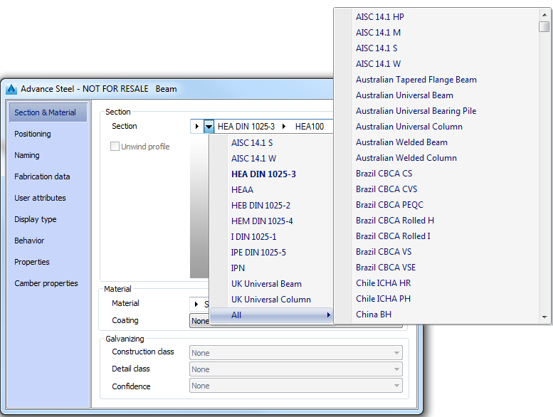

Modify the beam section
  1. Select the beam.
  2. Right click and select Advance Properties from the context menu.
  3. In the properties dialog box, go to the Section & Material tab.
  4. Select the beam section class, section type and size from the drop-down list displayed by clicking the corresponding arrow .
Note: If the desired section type (or the section size) is not in the list, selecting All displays all available section types (or section sizes) in the database.
