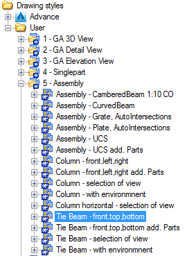

For this example we will use the drawing style Tie Beam - front,top,bottom from the Tie Beam category.
- Open the Drawing Style Manager: Output
Document Manager
(Drawing Style Manager)

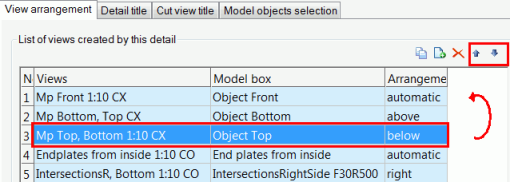

- Browse to the Tie Beam - front, top, bottom drawing style.

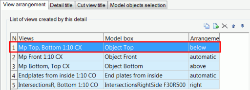

- On the View arrangement tab, use the arrow buttons in the top right corner to change the view position. Move the 3. Mp Top, Bottom 1:10 CX view to the top of the list (1.).

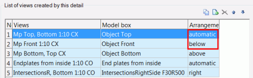

- Reassign the "arrangement" for the new view setup by setting the No 1 : Mp Top, Bottom 1:10 CX as "automatic" and No 2 : Mp Front 1:10 CX to "below".

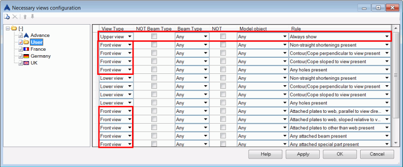

Necessary view configuration
- Open the Necessary view wizard: Output
Document Manager
- Set as active the User profile, as this is the only profile that can be modified.
- In the configuration list, change the view type as follows:
- The first line contains the Front view with the rule Always show. As the top view became now our default view, change the view type to: Upper view.
- From the second line we have a series of "Upper views" configured with rules that makes the drawing style display them if it detects various features present on the respective view. As the front view took the place of the Upper view in our example, we need to change all the view types for the lines that are configured for the Upper view to: Front View.

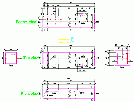

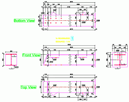

The result of this configuration is the following:
Original configuration | Top view set as default view |
