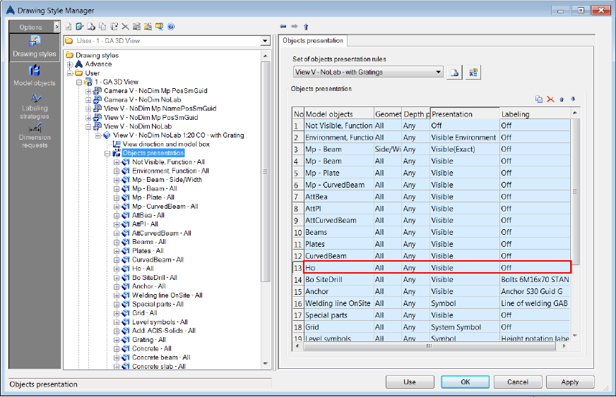

By default, the display of holes is disabled in the drawing styles for a faster detailing process. You can configure the drawing style to display bolts and holes as follows:
- Open the Drawing Style Manager.
- Output
Document Manager
(Drawing Style Manager)
- Output
- Select an overview drawing style. For example: ViewV - NoDim NoLab.
- Select Object presentation.
- Check if a model object named Ho exists. If it does not, create one by clicking the "Add a new object presentation" icon.
The model object will be added at the end of the list.
Next, configure this model presentation for holes:
- In the "Model objects" window, select Ho located in the "Holes" category.
- Make the following settings:
- Geometric Restriction: All
- Depth position: Any
- Presentation: Visible (to display only the visible holes) / VisibleHidden (to display the hidden holes as well)
- Labeling: Off
The hole model object should look as shown below:
