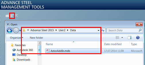

  2. Select the Table editor.
  3. Based on the category of the drawing style (Advance or User), open the following database clicking (Open database):
    • AstorDetails database: ...\ProgramData\Autodesk\Advance Steel 2025\[INSTALLATION LANGUAGE EXTENSION]\Steel\Data\ (for drawing styles used from the Advance category)
    • AstorAddIn database: ...\ProgramData\Autodesk\Advance Steel 2025\[INSTALLATION LANGUAGE EXTENSION]\User2\Data\ (for drawing styles used from the User category).

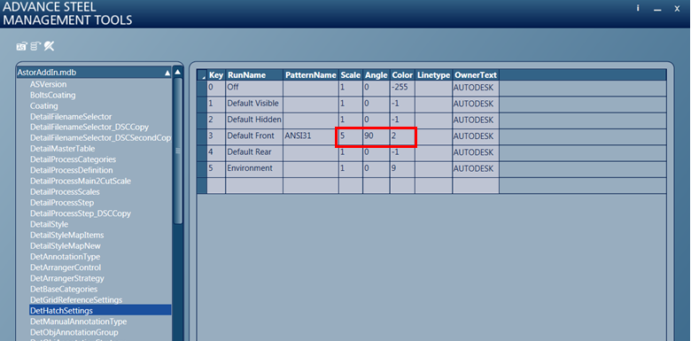

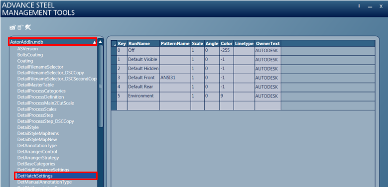

  4. Open the DetHatchSettings table.
    The various types of hatches that can be configured into an object presentation are available. The default hatch, used by both automatic and manual cut views, is Default Front.
    The following parameters can be configured:
    • PatternName.
      Any pattern available in AutoCAD can be used in addition to the ones added by the Advance Steel installation.
    • Scale
      The scale of the pattern. The default value is 1.
    • Angle
      The angle of the pattern. The default value is 0. The pattern is rotated counter clockwise for positive values.
    • Color.
      In addition to the available normal color codes, two special codes can be used:
      255 - None
      -1 - Read code from defaults. If we use this setting, then the color will be read from a specific default value. For example, for the Default Front hatch, it will read the color from the "Drawing-Presentation / Color of planes of intersection" default.

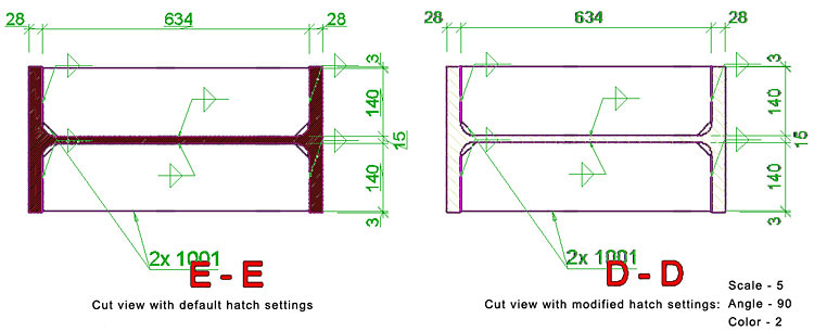

As an example, change the scale and color of the Default Front hatch with the following values:
  • Scale - 5
  • Angle - 90
  • Color - 2 (Yellow)
