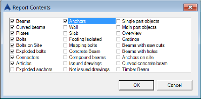

To have anchor bolts in lists it is necessary to add them to the report contents the template is using.

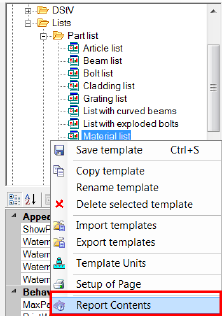

  1. In the BOM editor, browse to the list to modify.
  2. For example, right click on "Material List" and select Report Contents from the context menu.
  3. In the "Report Contents" dialog box, select "Anchors".
  4. Click OK and save the template.
