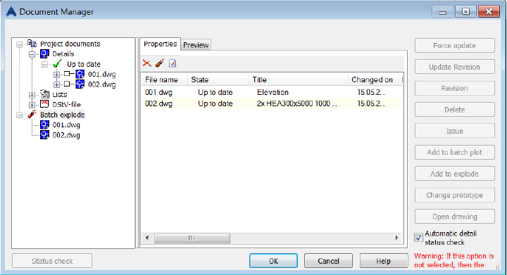

- Open Document Manager: on the ribbon, click
(Document Manager). - Home
Documents
(Document Manager) - Output
Document Manager
(Document Manager)
- Home
- Select the detail drawing(s) and click Add to explode.
The selected detail drawings appear in a new branch named Batch explode.
- Click on the Batch explode category.
You can remove the detail drawings from this branch using Delete (

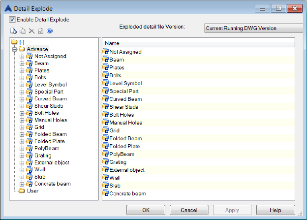

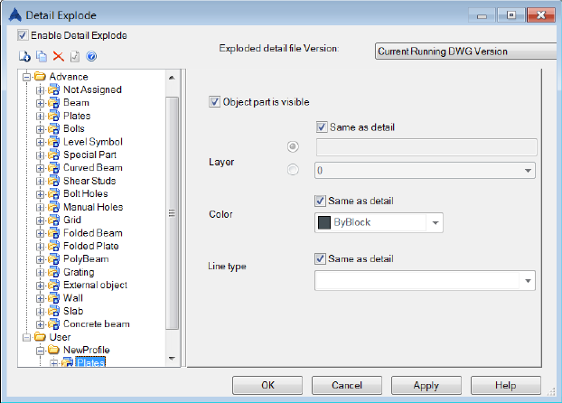

To access the detail explode settings
- Click
. The Detail explode dialog box appears.
- Enable details explode by clicking the corresponding option. When you call explode on a detail element the whole detail and all related elements are exploded as it's currently.
- If "Enable Detail Explode" is disabled, the objects from detail(s) are drawn with the detail color and linetype of the object.
- If "Enable Detail Explode" is enabled the current selected profile and Advance Steel settings are used.

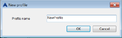

To define a new profile
- Click
. - In the New profile dialog box type the name of the profile.
- Click OK.
An easier way to create new settings is to copy categories from an already created profile and modify them.

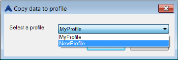

To copy a category
- Select the category and click
. - Select from the list the destination profile and click OK.
The category is copied to the new profile.
Other categories and / or settings can be copied using drag and drop.

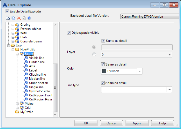

On the right side of the window define the explode settings. Object / Sub-object can be turned ON or OFF, can be placed on a different layer and can be represented with a different color or line type.

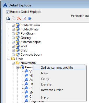

To set one profile as current
Right-click the profile and select the "Set as current profile" option from the context menu.
While exploding the detail, for each object / sub-object a corresponding setting will be searched in the "Current Profile". If there is no setting, the explode settings will be used from Advance Steel category.
