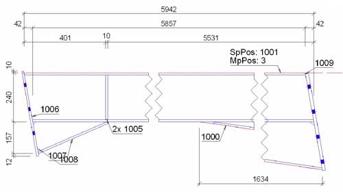

In case you have an assembly with some skewed parts, (depending on the Drawing Style configuration) you can get an assembly drawing where the skewed part(s) get clipped (like shown on picture below for the right-side haunch).

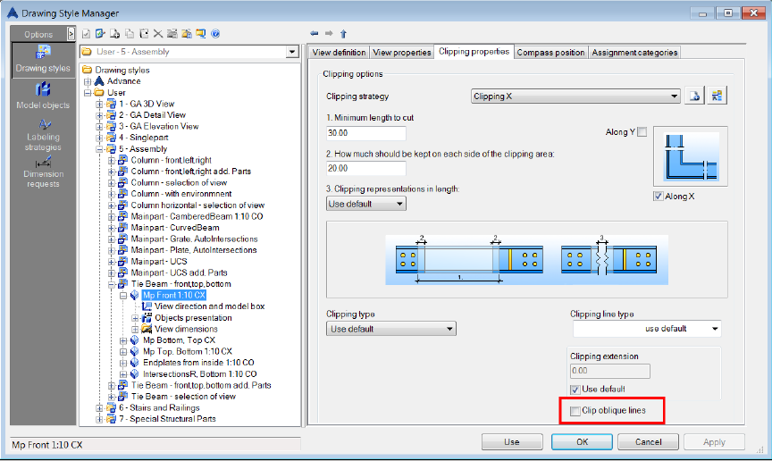

In case you do not want to get such a clipping, you need to adjust the Drawing Style in the Drawing Style Manager.
- Start the Drawing Style Manager: On the ribbon, click
(Drawing Style Manager). - Output
Document Manager
- Output
- On the Clipping properties tab of the concerned view (e.g. Front view), unselect the Clip oblique line option.

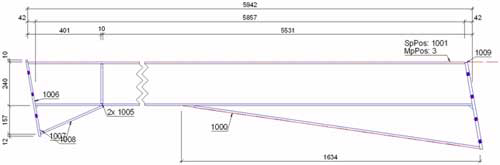

Next time you will use this Drawing Style, you will get a drawing without any clipping on skewed parts, like shown on picture below:
