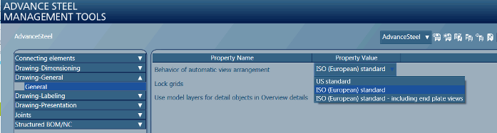

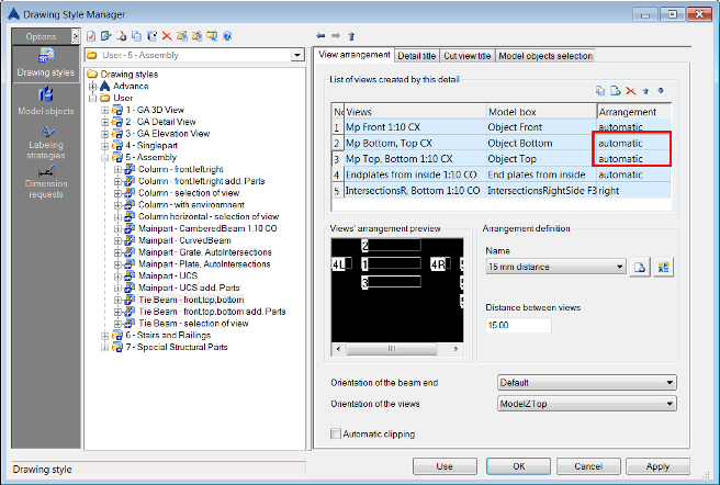

Within each drawing style the "arrangement" setting for each view must be set to "Automatic". See the following figure. Views with Automatic arrangement will be placed according to the default projection but views with any other setting will be placed as stated in the style.
The default behavior of the view arrangement it is set in the Management Tools.- Start the Management Tools: Home
Settings
(Management Tools)
- Select Drawing-General
Behavior of automatic view arrangement.
- In order for this setting to have the desired effect, modify the drawing style accordingly.
Within each drawing style the arrangement setting for each view must be set to Automatic (see the following figure). Views with Automatic arrangement will be placed according to the default projection but views with any other setting will be placed as stated in the style.
