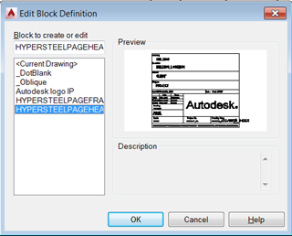

  2. On the command line, type BEDIT and press Enter.
    A dialog box appears.
  3. Select HYPERSTEELPAGEHEADER.
  4. Click OK.

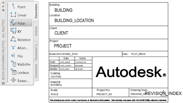

  5. Make the desired modifications.
