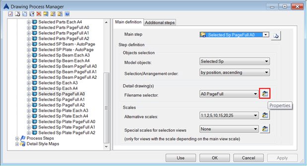

The detail drawing filenames are issued based on a setting in the drawing process manager. This name can be changed and tokens can be used to customize it. To change the drawing filename, you need to:
  1. Open the Drawing Process Manager:
    • Output Document Manager (Drawing Process Manager)
  2. Select the process with the filename to change and click the "Properties" icon in the "Detail drawing(s)" section.
  3. In the Drawing name field you can define the filename for the detail drawings created by this process. Any name can be used; in addition tokens can be added to this name, extracting various model information (as the part mark of the detailed objects).
