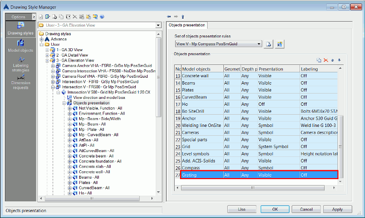

To detail a grating in the overview drawings, it needs to be added to the drawing style.
  1. Open the Drawing Style Manager: Output Document Manager (Drawing Style Manager).
  2. Select a drawing style in which you want to add the grating representation, for example, Intersection V - FR500 - Gr Mp PosSmGuid. Then, go to the Object presentation.
  3. Add a new object presentation:
  4. Configure the new presentation with:
    • Model object: Grating
    • Geometrical restrictions: All
    • Depth position: Any
    • Presentation: Visible (to represent only the grating contour) or Visible HatchVisible (to represent the hatch as well).
    • Labeling: Off, or any other label if the grating mark needs to be displayed.
  5. Click Apply to save the drawing style.
