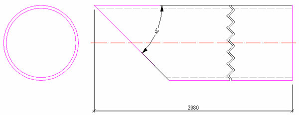

You can add on an existing drawing (general arrangement drawings, single part shop drawings, assemblies etc.) an angle dimension for the dimensioning of: sloped profiles, profile sections, drawings intersections etc.

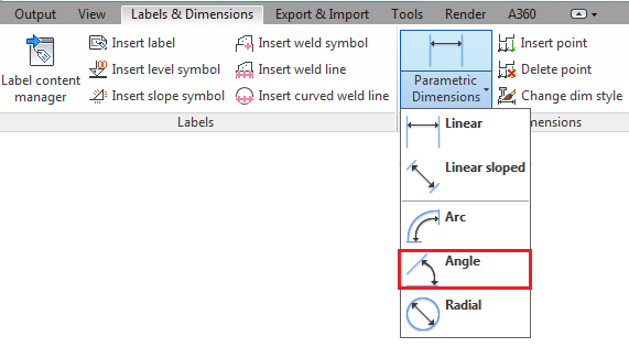

To display the value of an angle on a drawing, use the Dimension angle tool on the Label & Dimensions tab.

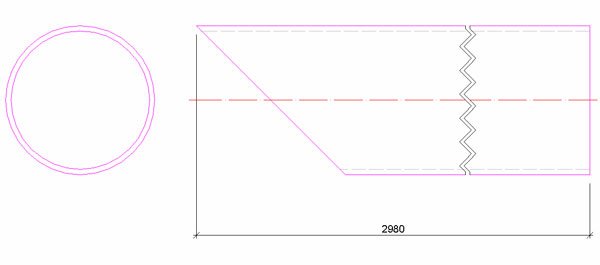

In the example below you will add an angle dimension representing the section of a tube.

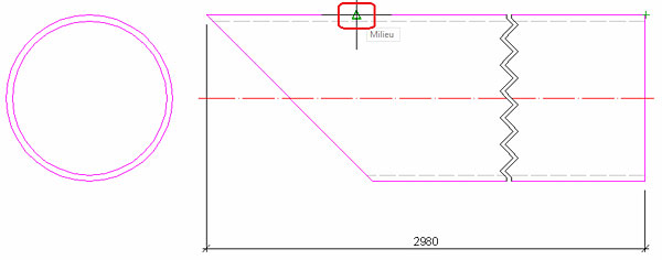

Adding the angle dimension requires the following steps:

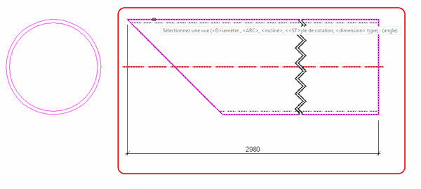

  1. Selecting a view: Click on the desired view to add the dimension angle.

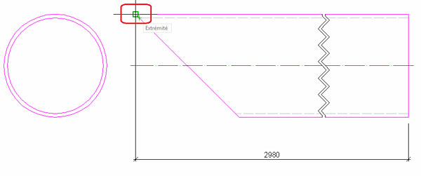

  2. Starting point "0" of the line: Select the origin point of the dimension angle, forming the intersection of the two lines.

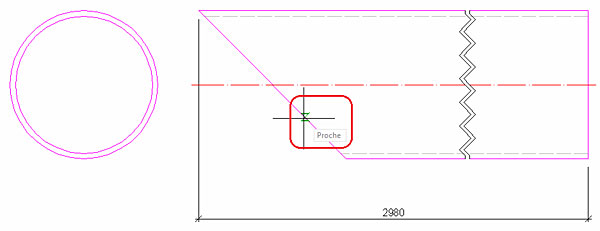

  3. End point "0" of the line: Select a point situated on one of the lines forming the angle.
  4. Placement point of the dimension line: Select a point that will correspond to the position of the angle information.

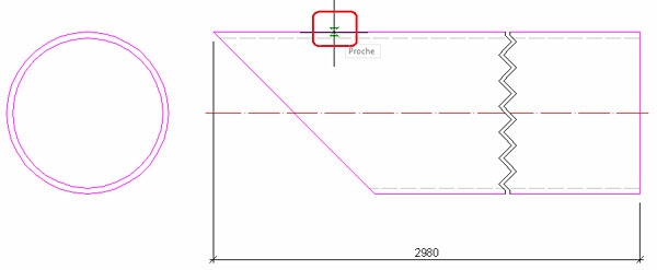

  5. First point for the second line: Select a point situated on the second line forming the angle.
  6. Press Enter twice to close the command. You will obtain the angle dimension.
