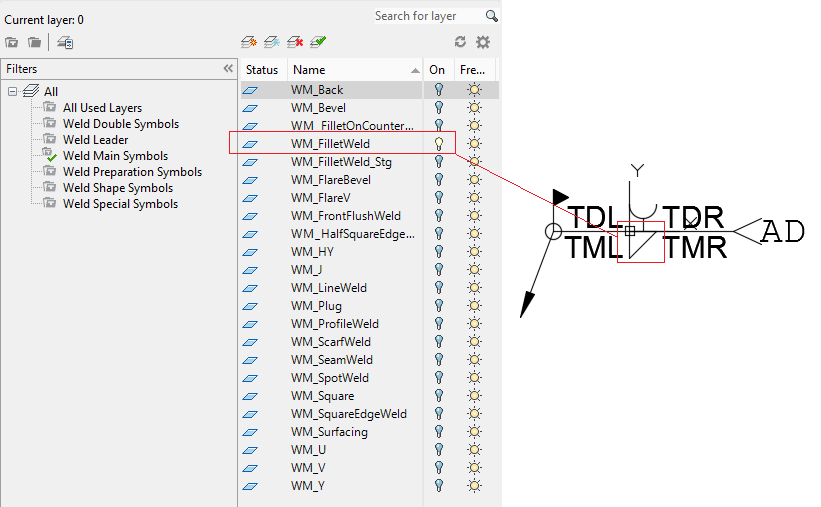

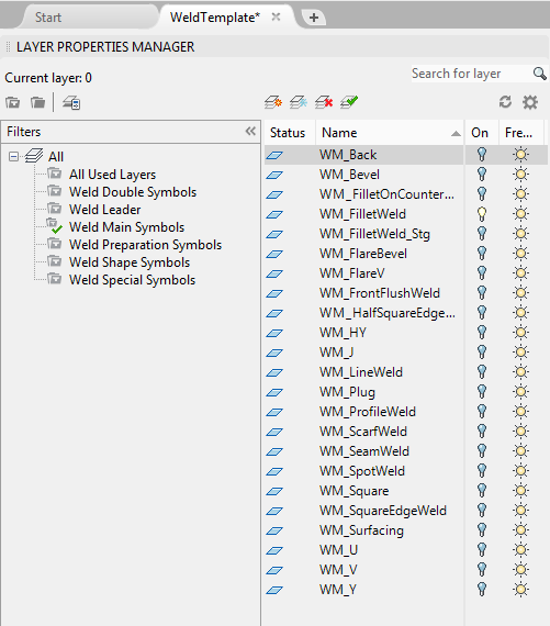

- Open the Layer Manager.
Note: Starting with Advance Steel 2016, each weld symbol is drawn on a separate layer (e.g. fillet weld symbols are drawn on WM_FilletWeld and WD_FilletWeld layers)."WM_","WD_", "SM_","SD_","PM_","PD_" are acronyms for Weld Main, Shape Main, Preparation Main etc, and are not mandatory but are recommended for organizational purposes.
- Identify the weld symbol layer and turn it on. Turn off the other layers to avoid overlapping symbols.
- Make the desired modifications.
