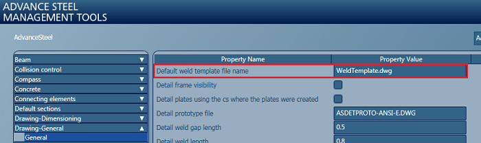

- Open the Management Tools application and check the default where the weld symbol template DWG name is specified.
Open
(Management Tools)
Defaults category
Drawing-General
General
Default weld template file name:
Note: In this case, the weld symbol template file is WeldTemplate.dwg. This file may differ from one installation to another (e.g. different languages). - Open the "WeldTemplate.dwg" located in ...\ProgramData\Autodesk\Advance Steel 2025\[INSTALLATION LANGUAGE EXTENSION]\Shared\Support\Symbols

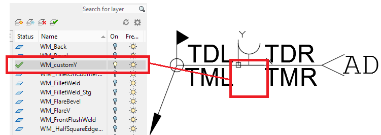

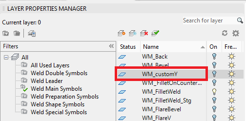

- Open the Layer Manager and create a new layer.
- First, create the weld main symbol for the new "Y" weld type. The new layer name should contain the "WM_" prefix followed by the desired name (for example, "WM_customY").
Note: Starting with Advance Steel 2016, each weld symbol has its own layer."WM_","WD_", "SM_","SD_","PM_","PD_" are acronyms for Weld Main, Shape Main, Preparation Main etc. They are not mandatory but are recommended for organizational purposes.

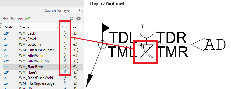

- Turn off all the other layers that are associated with weld main symbols, to avoid overlapping of symbols.
- Turn on the new layer (WM_cutomY) and set it as the current layer.
- Draw the desired symbol (be sure to draw on the correct layer).

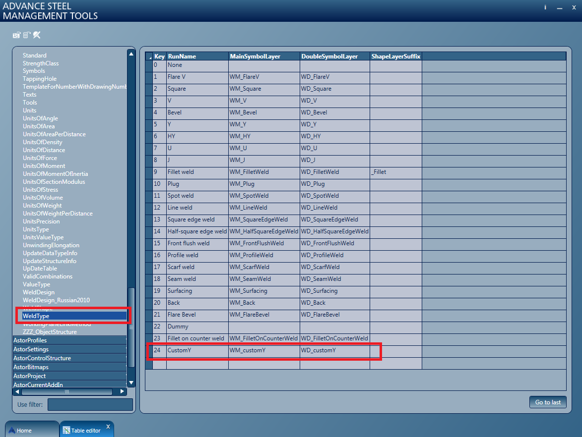

- In Management Tools, start the Table editor.
- Click the Open ODBC icon and select AstorBase.
- Open the WeldType table.
- Fill in the description for the new weld on the last free line:
- Key = next available number.
- MainSymbolLayer=The name for main weld symbol layer from "WeldTemplate.dwg", for example, WM_customY.
- DoubleSymbolLayer=The name for double weld symbol layer from "WeldTemplate.dwg", for example, WD_customY.

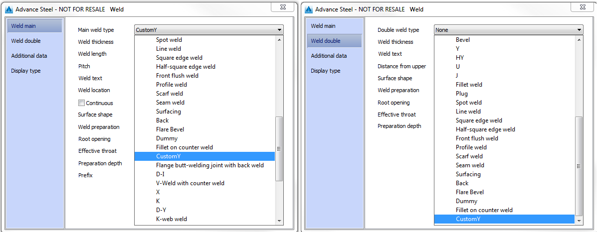

- The new weld type is now available in the Weld dialog:
