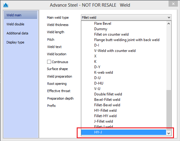

  11. The new combined weld symbol is available in the Weld dialog:
