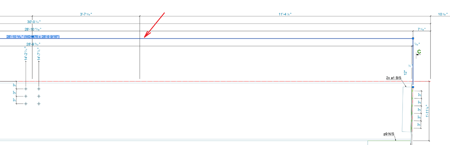

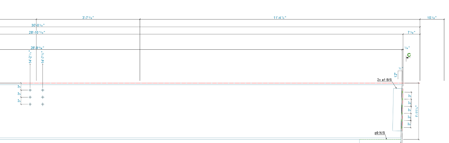

Example: Delete an automatic dimension on a beam assembly drawing, as in the example below:
After updating the drawing, the three dimensions chains above the deleted one will rearrange themselves to occupy the gap.
Note: This behavior will always appear if you fill the gap with a manual dimension before updating the drawing - the automatic dimensions above will still shift position, overlapping the manual dimension.

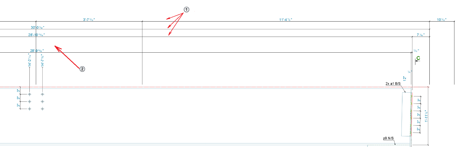

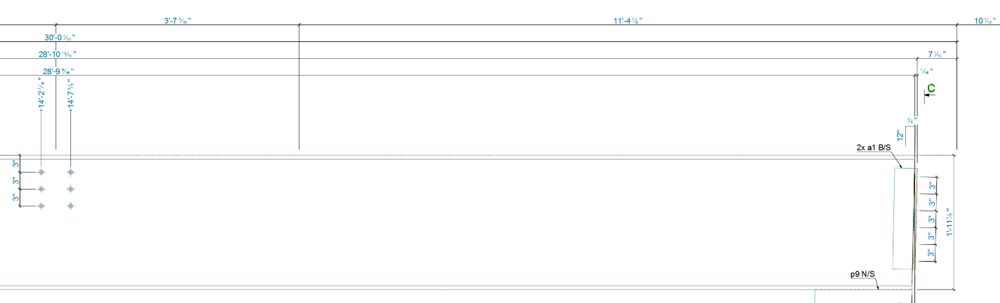

Example: Using the same case as previously, after deleting the automatic dimension chain in the middle, the position of the three dimension lines above it are manually modified before updating the drawing:
* - The three manually repositioned dimension chains above the deleted automatic dimension chain.
* - The gap left by the deleted automatic dimension chain.
After the update, the manually modified automatic dimensions do not reposition, and the gap is still present. A manual dimension could be created in this gap, and the overlap would not appear as mentioned before.
