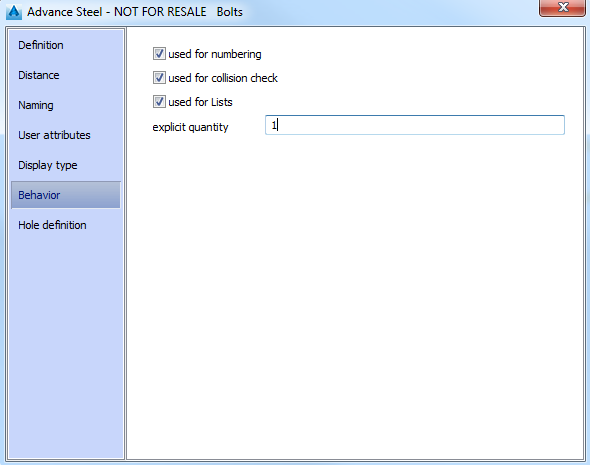

On this tab of the properties dialog box, you can select the bolt behavior at collision check and numbering.
Option Description
Used for numbering The bolt is used for numbering.
Used for collision check The bolt is used for the collision check.
Used for lists The bolt is used in the bill of material.
Explicit quantity Defines the amount in the bill of material. Therefore, it is possible to create one part in the model and multiple parts in the BOM.
