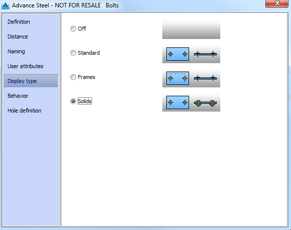

On this tab of the properties dialog box, you can select the way the bolts display in the model.
| Display type | Bolts | Description |

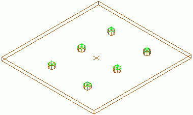

| Off |
Only the holes are displayed. |

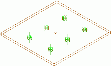

| Standard |
Section edges and processing objects. |

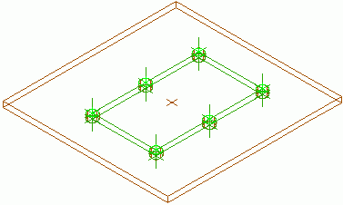

| Frames |
The definition frame is displayed. |

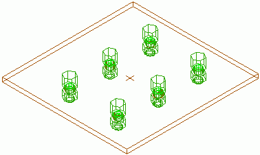

| Solids |
The bolt and nut solids are represented. |
