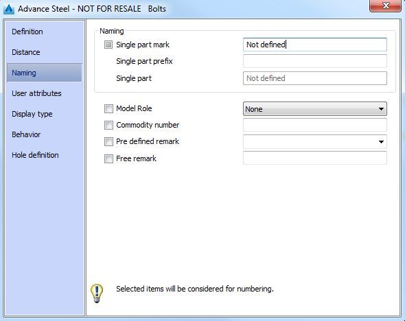

On this tab of the properties dialog box you can define the information to display in the bills of material and to select the properties to be taken into account in the numbering process.
| Option | Description |
| Naming | |
| Single part mark |
| Single part prefix | Defines the prefix for the single part mark. You can change the prefix using the Change prefix tool. |
| Single part counter |
| Model role | Assigns the role in the model. It is considered e.g. in the drawing creation to assign a presentation, dimensioning and labeling style. |
| Commodity number | Defines the commodity number of the element. |
| Predefined remark |
To add a predefined remark, access the AstorBase database, located in ...\ProgramData\Autodesk\Advance Steel 2025\[INSTALLATION LANGUAGE EXTENSION]\Steel\Data Open the database using SQL server and configure your Denotations in the Notes table: ![]() |
| Free remark | Other notes concerning the element. |
