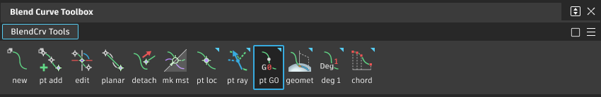

Access these tools from the Blend Curve Toolbox:

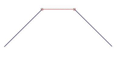

Positional Continuity (G0)
The dashed curve touches the two solid curves, but there is an angle between them and so there is a sharp break between the curves.

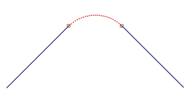

Tangent Continuity (G1)
The dashed curve has no angle difference where it meets the solid curves. The Round surface tool and the Curve Fillet tool create this type of continuity.

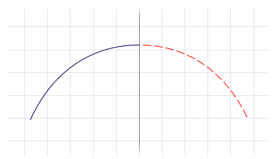

Implied Tangent (G3, G4)
A curve or surface is created on the center line, and will be mirrored. The Implied Tangent tools make sure that the two surfaces (original and mirrored) will be tangent to each other.

  • In Blend Curve Toolbox, choose the continuity level by selecting the Constraint Continuity tool G0 to G4.
