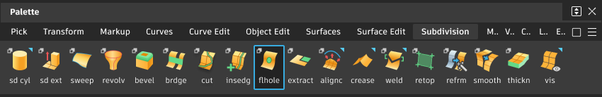

Access the tool from the Subdivision Palette:
Subdiv Fill Hole settings
