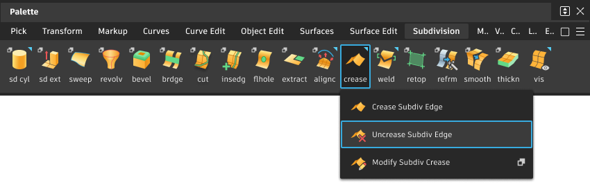

Access the tool from the Subdivision Palette:
Uncrease a subdivision edge

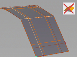

  1. Choose a picking method for selecting the edges you want to uncrease.
  2. Select one or more edges that have already been creased.
  3. Select the Uncrease Subdiv Edge tool.
    The creases are removed from the edges that you selected.
