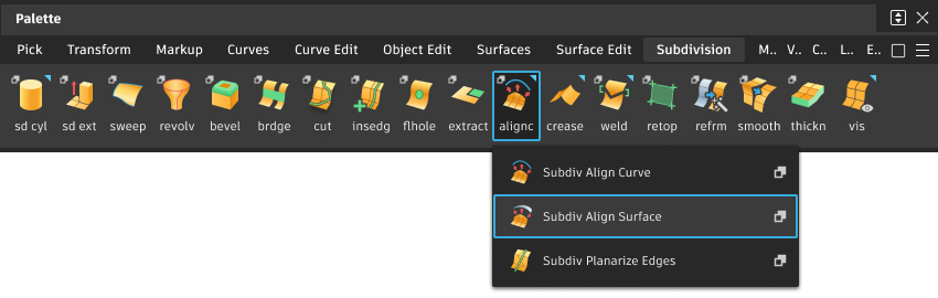

Align to Surface
Aligns selected CVs and associated edges of a subdivision object to a NURBS surface. Use this tool to smooth or modify selected CVs using a NURBS surface.
You can use this tool to align selected CV's to a NURBS surface in the following ways:
  • Automatically align the selected CVs
  • Use an existing NURBS surface to drive CV alignment
  • Have the Align to Surface tool generate a new NURBS surface to drive CV alignment.
Access the tool from the Subdivision Palette:
