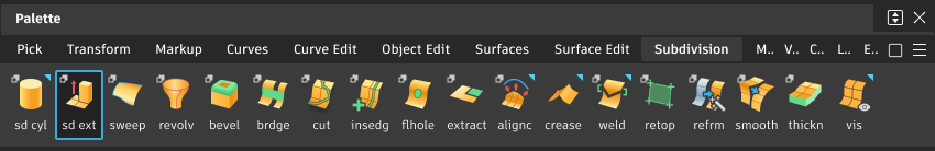

Access the tool from the Subdivision Palette:

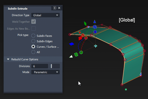

Subdivision Extrude settings
Direction Type
Specifies the direction of the extrusion.
Normal - Extrudes along the edge and surface U and V directions. The Normal direction is at 90 degrees to the curve or surface direction. Global - Extrude along the X, Z, or Y axes.
Weld Together
When on, continuous edges or faces are merged and extruded.
Edge as New Bodies
When on, a new subdivision object is created from an extruded edge.
Pick Type options
Subdiv Faces - Extrudes only selected subdivision faces.
SubdivEdges - Extrudes only selected subdivision edges and curves.
Curves/Surface Edges - Extrudes only selected curves of all types, including or NURBS surface edges.
All - Performs extrusion depending on the current selection.
Rebuild Curve Options
Divisions
Specifies the number of CVs to add along an extruded curve or surface edge. To use this option, curves and surface edges must be degree 2 or greater.
Divisions: 3 to 10
Mode
Specifies how the CVs get distributed along the extruded curve.
Parametric - Uses the parametric space to distribute the CVs.
Uniform - Distributes the CVs evenly along the length of the input curve. When you select this mode, you can use Curvature Bias to adjust the how curvature affects the distribution. For example, you can add Curvature Bias to distribute more of the CVs to areas with greater curvature.
Curvature Bias
(Available only for Uniform Mode) When set to 0, the CVs are evenly distributed. As you increase this value, the input curve's curvature has a greater effect on how the CVs get distributed. For example, more CVs get placed in the areas of greatest curvature. Use this to produce smoother extruded surfaces particularly around areas with pronounced curvature.

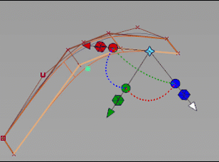

The extrude in-canvas manipulator provides way to quickly toggle between Normal and Global.
Select the geometry entities you want to extrude.
Tip: You can preselect the geometry including edges loops and faces using the Pick tools. Use Shift + MMB to chain-select edges and faces.Use the manipulator to move, scale, or rotate the geometry as you extrude it.
To complete the extrusion, click Extrude Again or press the Spacebar.
