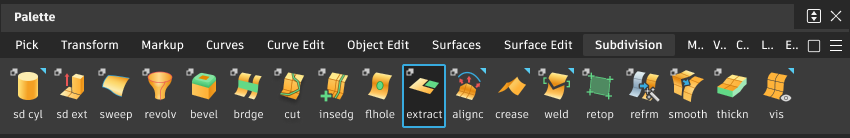

Duplicates or separates selected subdivision faces from a subdivision object. Use this tool to duplicate specific regions of a subdivision object to create new individual objects.
You can choose to remove the extracted faces from the source subdivision object or keep them in the original object.
Access the tool from the Subdivision Palette:
