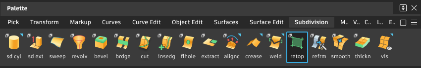

Access the tool from the Subdivision Palette:

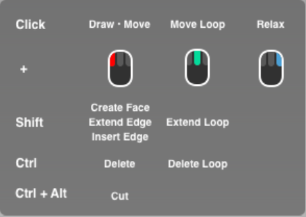

Show Hotkey Help
Toggles the hotkey help overlay image on and off.

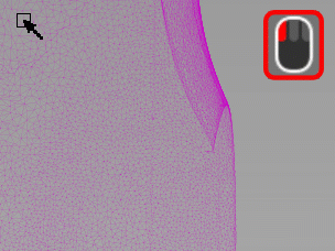

Note: Preselecting a reference object before accessing the tool also sets it to the tool.Click anywhere on the reference mesh or object.
A green dot appears and snaps the surface of the reference mesh. These dots become the vertices that create the framework for your subdivision faces.

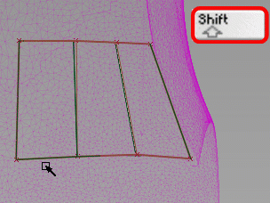

Tip: You can move a dot by dragging it or delete it by pressing Ctrl + click after you have dropped it on the reference object.Continue to drop dots until you are ready create faces between them. To do this, move the cursor over the dots while holding Shift. The tool enters face preview mode highlighting the possible faces.
Shift-click a preview face to create it.

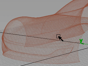

You can snap an existing subdivision surface to a reference mesh or NURBS object, and then shape the subdivision body using the reference object as a guide.
Select the tool.
In the viewport, pick the reference object, and then click Next.
Pick the subdivision body you want to reshape, and then click Go.
With the subdivision model now projected onto the reference object, the CVs snap to the reference surface.

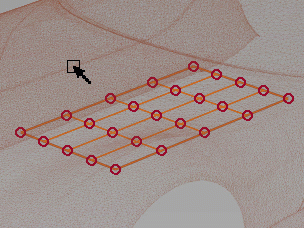

Note: If the subdivision CVs are not snapping to the reference object as expected, try adjusting the Snapping Distance in the Retopo tool options.Begin reshaping your subdivision body to fit the form of the reference object by dragging CVs and edges or MMB dragging edge loops.

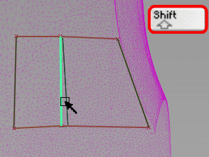

Move the cursor over the subdivision surface while holding Shift.
The tool's preview mode highlights the new edge.
Position the edge preview and click to add it to the subdivision body.

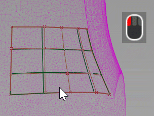

- Apply Relax by moving the cursor over the surface while pressing the RMB.

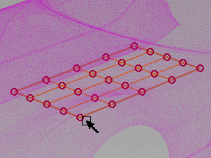

Move the cursor over an edge or CV while holding Ctrl + Alt.
A green dot appears snapped to the edge or CV.
Do one the following:
- To cut an edge at a point along its length, position the dot at start of the cut and click.
- To cut from the location of a selected CV, click.
- In either case, a red line displays with its end at the cursor. This indicates the path of the cut.
Move your cursor to direct the line to position of the cut end, and the click.
