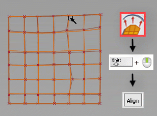

Automatically align selected CVs
  1. Shift-select the tool to open the control window
  2. In the control window, set the following:
    • Select an Approximation option.
    • Select a Projection Type to specify the way the alignment curves get projected onto the subdivision surface.
    • Select Distribution Type to specify how the CVs get spaced when aligned.
  3. Select the CVs you want to align.
    Tip: Use Shift + to chain-select CVs.
  4. Press Enter or click in the view.
    The select CVs are now aligned.

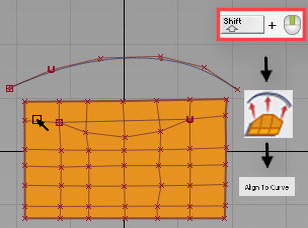

Align CVs using a selected curve or edge
  1. Shift-select the tool to open the control window.
  2. (optional) Turn on Create History.
    Tip: Use + to chain-select CVs.
  4. In the view, click .
  5. Select the curve to drive the alignment.
    The select CVs now align to the selected curve.

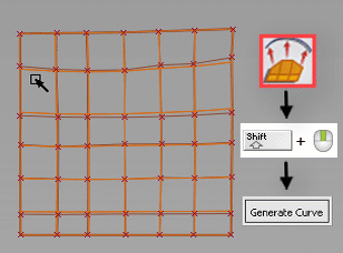

Align CVs using a generated curve
  2. Select an Approximation option.
  3. Turn on Create History. When off, you cannot use the Generate Curve method to align CVs.
  4. Select the CVs you want to align.
    Tip: Use + to chain select CVs.
  5. In the view, click .
    The CVs now align to the generated curve.
